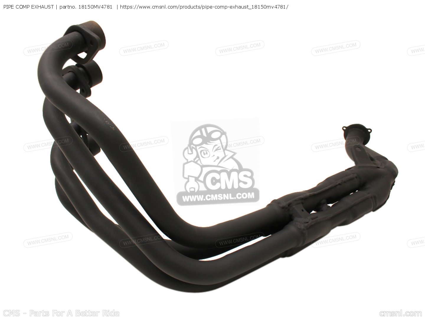

Nope there was a difference to the R model pipes as there are lots of minor differences as you know, I believe it was to help with power at mid range but not certain on that. You can see a visual difference to the down pipes if you goto the link I show below from cmsnl. The downpipes are a lot thinner and when you see both set of pipes together the R model set looks comically thin when your used to fatter pipes, or as my mate in his James May persona put it "awfully thin" note in the pics where the pipes meet the collector there is a visible step down compared to earlier pipes where the pipes did not have this step. Funny though that they do this then restrict the bike to 53bhp by other means..

R pipes.. http://images.cmsnl.com/img/products/pi ... 2_b92f.jpg

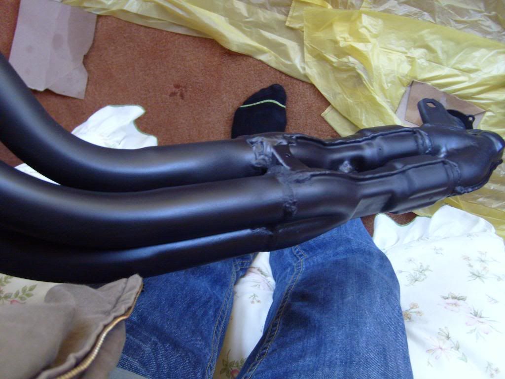

These are off mine and there is a step down near the collector but they did look to have been on for a long time before we got the bike way back in 2005

great pictures.. yep those are L or N pipes. I have cut a section of your photo to show the external differences with the R pipes, note where the pipes fit. But as its the inner that is the confusing bit, can you tell me if there is a plate further down the link pipe section?

I couldn't see anything down the link pipe section, i wonder if that is indeed some sort of restriction to get the power down

cbr400rrn wrote:I couldn't see anything down the link pipe section, i wonder if that is indeed some sort of restriction to get the power down
Well if you cant see anything similar down there and it is easy to see in good light being only 6" down, I guess im not going mad after all :grin:
Does look like another R specific item then, also looking on the back of the oem linkpipe there is also an obvious spot weld, no doubt keeping it in place. So there seems to be truth in this rumour I have propogated.. Now know why my oems seem different from the stainless unbaffled linked section pipes.
