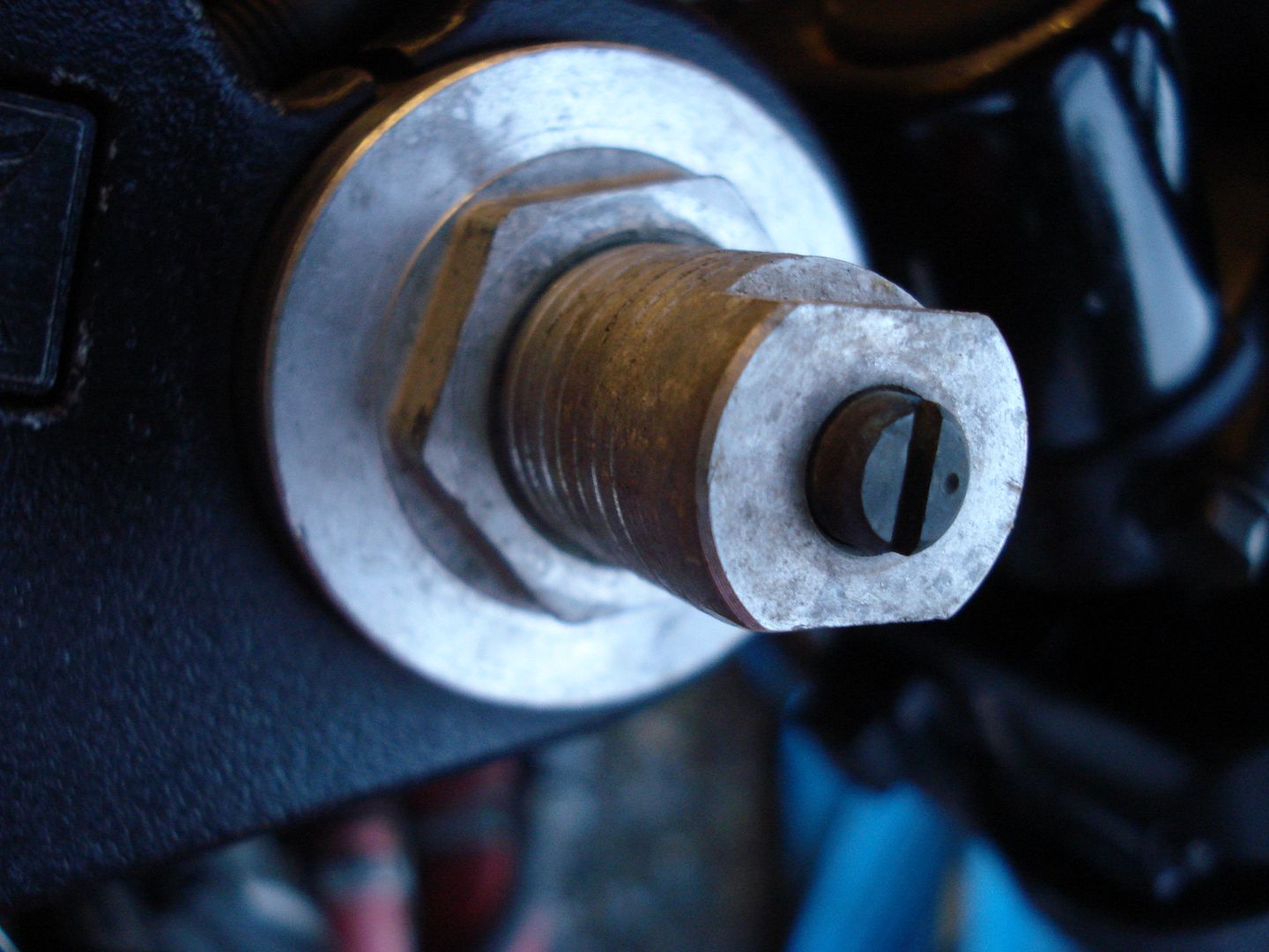

Hi,
I'm doing up my first NC30 project bike so forgive any dumb queries... are my forks the later ones with more adjustment?
Thanks,
Jeff

Later ones. ;-)

As above later type.
Probably need the preload (outer adjuster) turned in more than that unless the suspesnino is new and your about 8 stone.
Use a proper fitting screwdriver to adjust the brass screw, they are soft and small screwdriver will slip and take chunk out of it.
