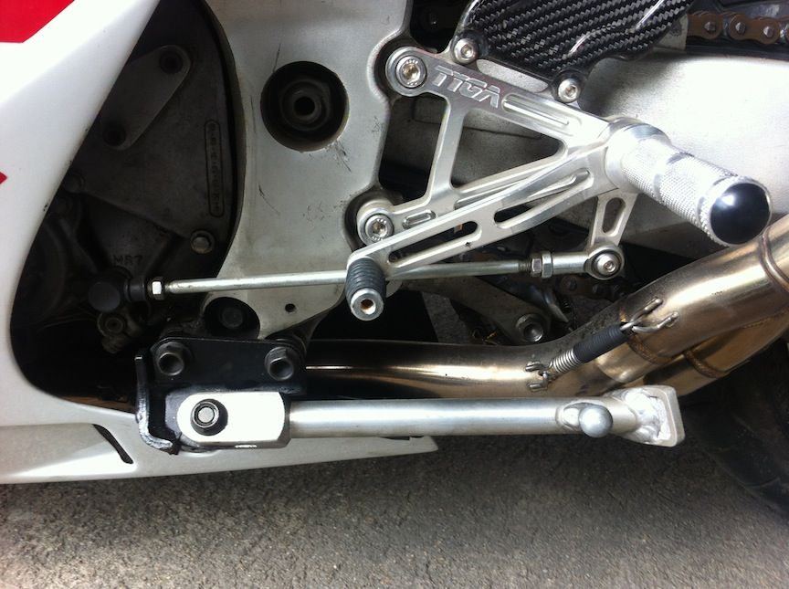

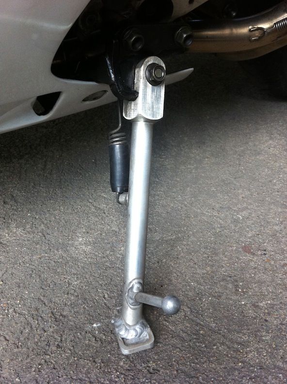

Post by J.B. » Thu May 23, 2013 12:48 am
This turned out better than expected:

J.B. wrote:This turned out better than expected:
That looks really good. Did you make it yourself?
