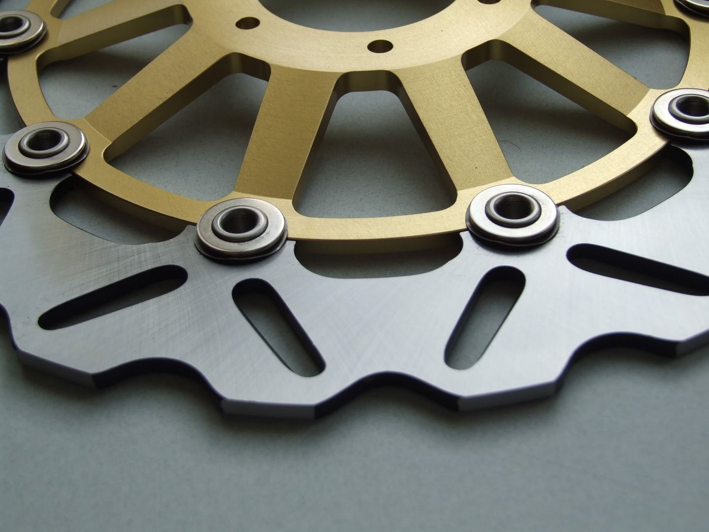

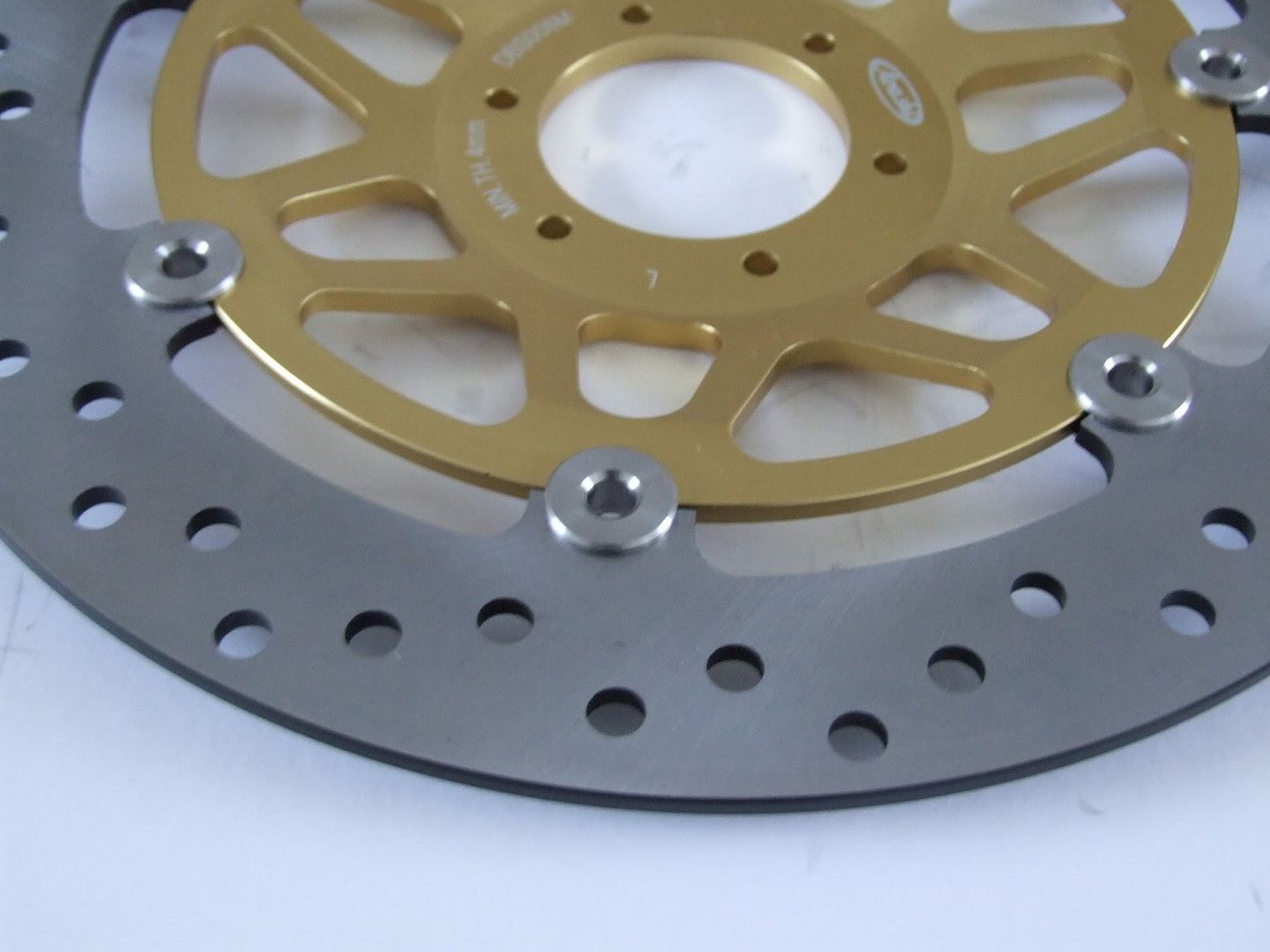

"EBCs are OK in my experience, OE are obviously the 'proper' option but
they are nothing special.
My other alternative is those Arashi discs... a very nice quality product
for the price as the attached pics will show."

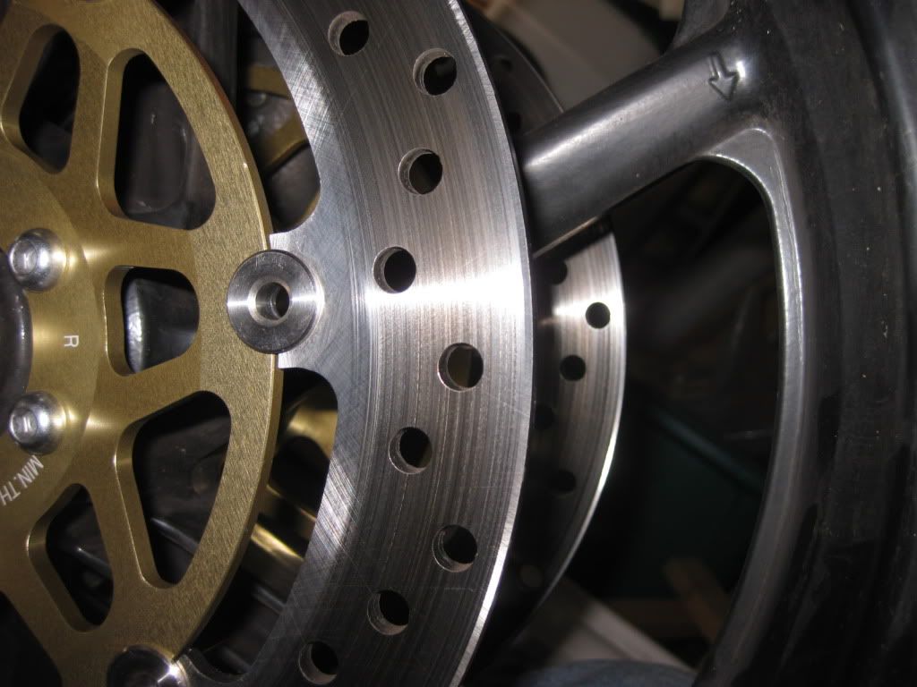

I wouldn't having gone through the ordeal that i did.

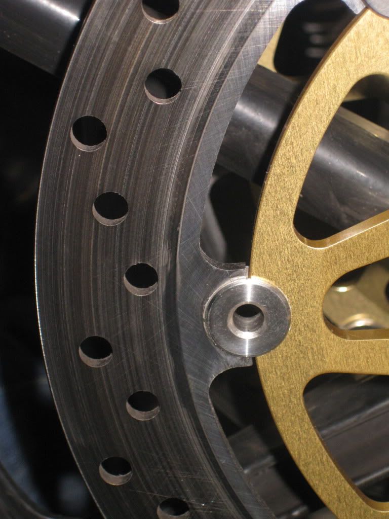

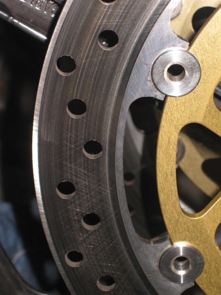

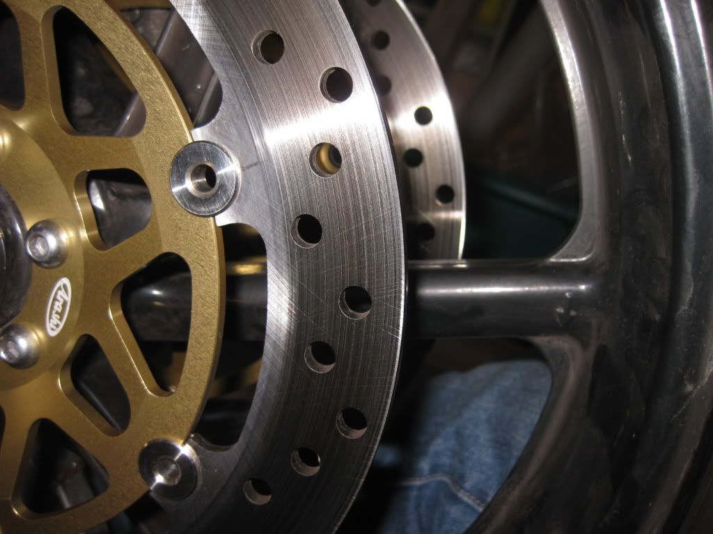

I bought some through Rick O. They looked great and were a good price. But when i fitted to my bike they had a horrible wobble under braking. I looked down while riding and could see them wobbling. No side to side but up and down as in the center hole and bolt holes had been drilled eccentrically. When i got them off and some calipers out i measured that the hole was 1mm out of center. After i got them sent back direct to the factory they sent me some new ones. I thought that they would be fine as they assured me that they had checked their stock thoroughly. When i got these ones out i measured them up again and guess what, again eccentrically drilled holes on both discs. so 4/4 of the discs i got from them were unusable. The wheel is perfect and my other discs were replaced because they were below the wear limit and had a slight buckle.
Got my money back and went with some lovely Galfers and had have had no problems.
All in all Rick O was great to deal with. However the discs were not.
Ill get some pics up of the wear patterns on them

Re: Arashi brake discs
http://i1233.photobucket.com/albums/ff3 ... s/RHS2.jpg
http://i1233.photobucket.com/albums/ff3 ... s/RHS1.jpg
http://i1233.photobucket.com/albums/ff3 ... s/LHS2.jpg
http://i1233.photobucket.com/albums/ff3 ... s/LHS1.jpg
Especially on the last two where i got that side lined up better you can see the different areas where the wear occurred.
I have sold quite a few pairs of these discs and Harvey`s are the only ones which have given any problem.
Arashi did hold their hand up to a bit of faulty machine setting but then f*cked up completely by sending Harvey a replacement disc from the same bad batch which has left him with a jaundiced view, them embarrassed and me out of pocket in all directions.
Barring that one glitch I would say that the finish and build quality of the Arashis is on a par with OE Honda discs.

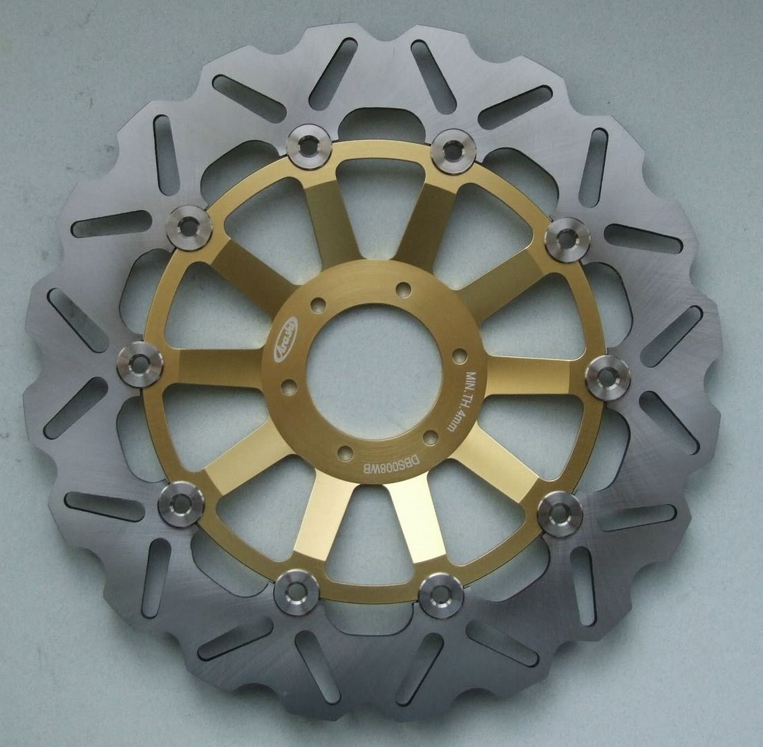

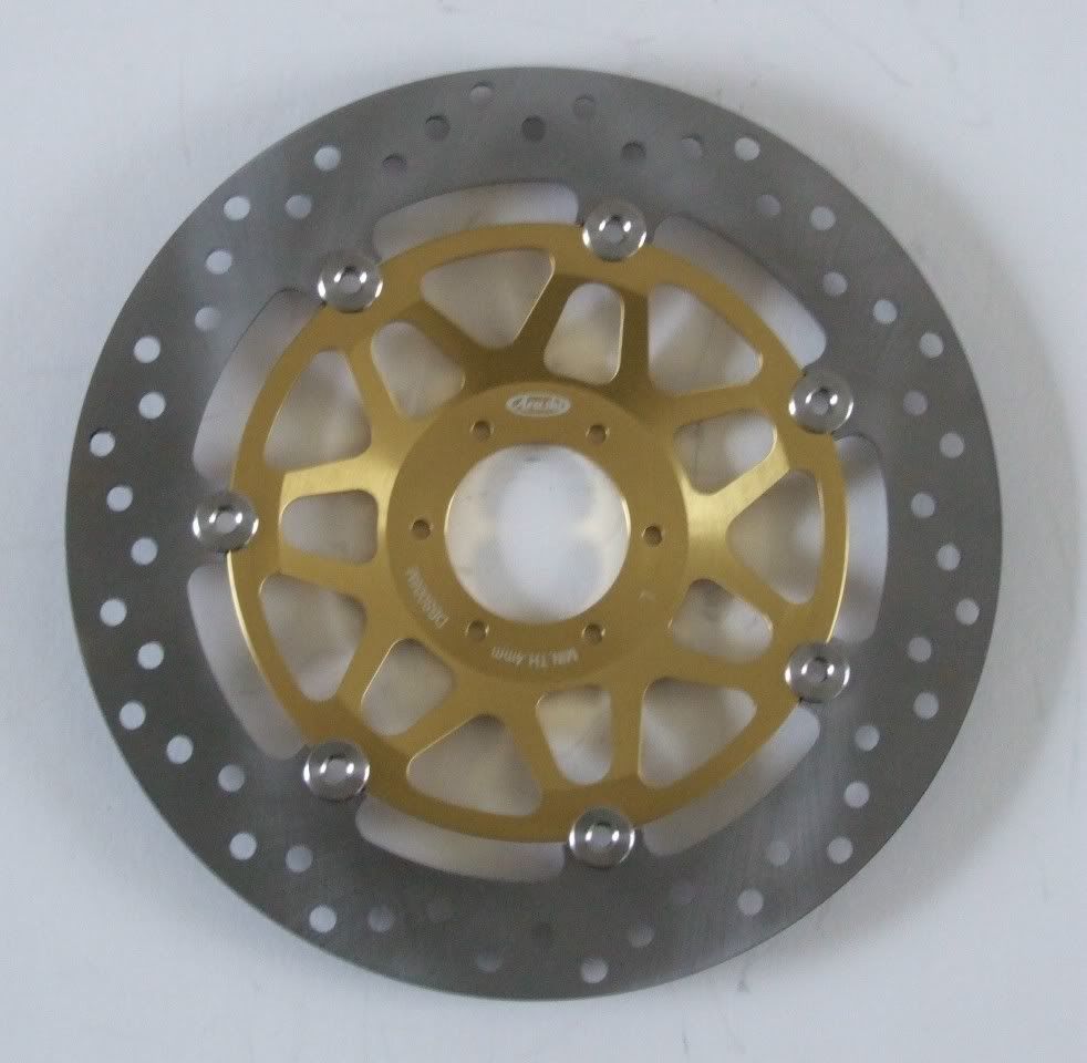

I'm loving the look of the round ones, not fussed on the contoured ones
