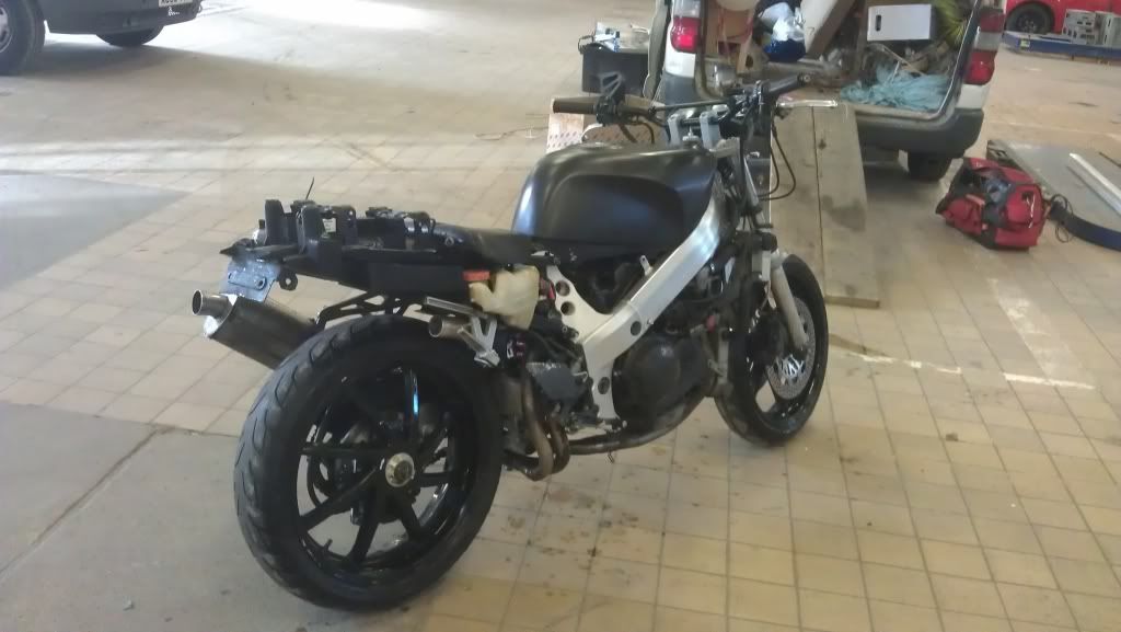

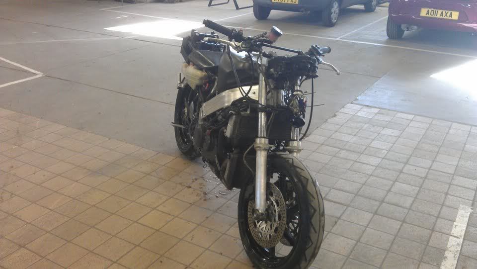

lillico
Posts: 17
Joined: Tue Oct 11, 2011 12:16 pm
Re: restoration nc30
Post by lillico » Wed Oct 19, 2011 4:21 pm
this is it after degreasing and steam cleaning...
This afternoon the rear subframe is off obviously along with all the loom, rear brake, chain guard, battery, tank.
Iv stripped the clocks off too..
whilst stripping the exhaust snapped a stud!! so gonna have to deal with that..
So far so good otherwise..
decition made phase one scheme it is...
