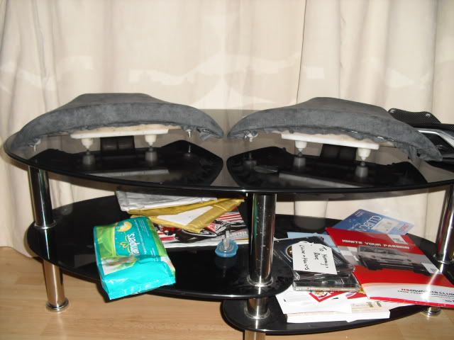

Thought i would share with you my trial seat to prevent me hitting the tank with certain parts of my anatomy which i would rather not mention :oops:
I've only just aquired the bike so perhaps my riding style is not yet suited to the VFR ;) but every time i've been out i have ended up sliding into the tank and it's not been the most enjoyable of experiences :lol:
Thanks to mattUKNC i got a spare donor seat and set about it.
In addition to the Alcantara like material i added another layer of foam for those long journeys :whistle:
The result feels very good so far but that's only sitting on it in the garage as it won't stop fookin raining :x
I'll put some pics up so you can see the result and i'll post the riding difference when i get the chance to get on it :lol:
Donor seat
Foam fitting
Original foam re-fitted
Bit of tape to stop staples scratching the paint
End result
A few pics on the bike
Conversion cost.
Seat £10 (thank you matt)
Material £4.80
Foam £4
and probably enough stuff left to re-cover it another 4 times :peace:
Right.... what's next :lol:

The material is from Dunelm mills, it's a manmade suede but if it works well i will replace with the real stuff or Alcantara as should be easier to stretch on corners.
Good spot on the snacks bag but have to report they are in separate bags inside. :grin:

All you need is some material (available in most fabric shops) some foam if you want the seat thicker, some spray adhesive and a staple gun. took about an hour to do.

i wouldnt go so far as saying its anti slip and its a bad call if it rains but i have done a few, (excuse the mess in the pictures)
