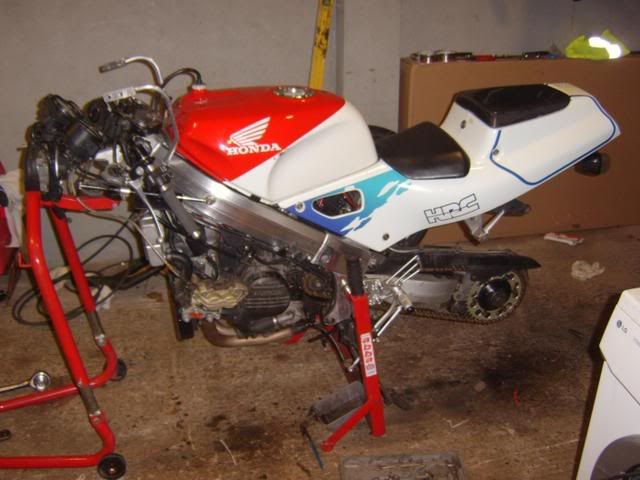

This was my method when doing the forks.
Wish i had bought my abba stand before hand though.
