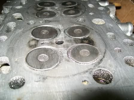

unfortunately the valves protrude out of the head, the combustion chambers are in the pistons, so the valve seats would have to be dropped, and from what they were saying its not slightly warped.
the head alone is £1200.00 with no valves!!!!, someone told me mitsi trucks were shit hot so thats why i got one, am sorry to say 2 1/2 months out of warranty and this am finding it a bit hard to believe there that good.
Come again ? :shock:
If the valves stick out they can be removed. Have you actually seen this setup or are you being taken for a ride ?

as you can see the valves have to be removed then the valve seats have to removed the head skimmed and then machine the valve seats recess and then refit the valve seats so to put the valves at the same postion, not many people take on the job, i have tried my local engine builder and the time involved out prices a head, if it can be done in the first place.
