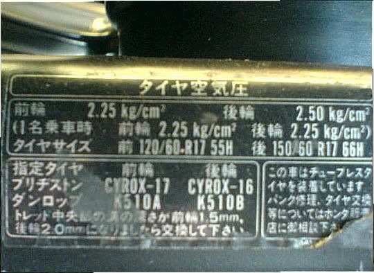

Hi guys
I have done a search but got no results. (Well, I tell a lie, I got one hit about hydraulic pressure.. Not really what I was after ;) )
What are the recommended tyre pressures for the NC29? (I normally go for the two's up / fast riding pressure)

Haynes says 33psi/2.25 bar front and 36/2.5 rear two-up mate.

aaahhh.. BUT....
it also depends on what your tyre manufacture recommends...this is what id go on personally
our Haynes was printed in the dark ages.. tyres have moved on a hell of a lot since it was printed.

This manufacturer recommends the vehicle manufacturers pressures, which are reproduced in the Haynes...
