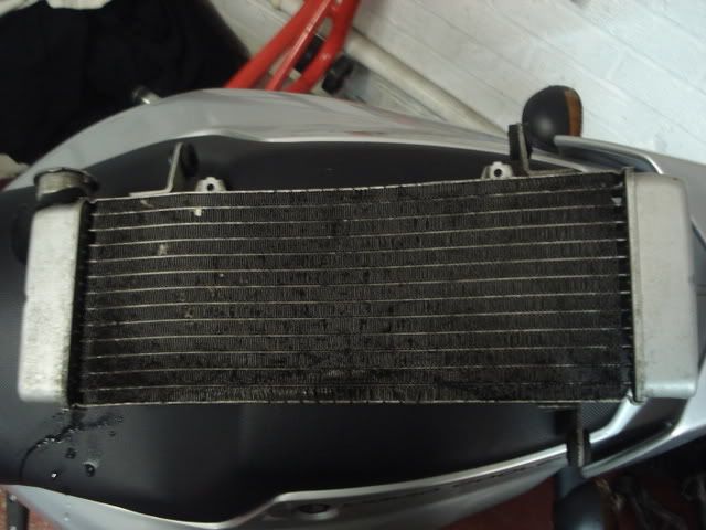

here's what I got up to today:
flushed the cooling system
removed the rads
test fitted the samco hoses
cleaned both rads
paint stripped the bottom rad
the lower rad is in a bad way but my bike takes ages to get up to temp let alone overheat so im not worried for now, but will deffinetly put a new lower rad on the mental shopping list for the future,

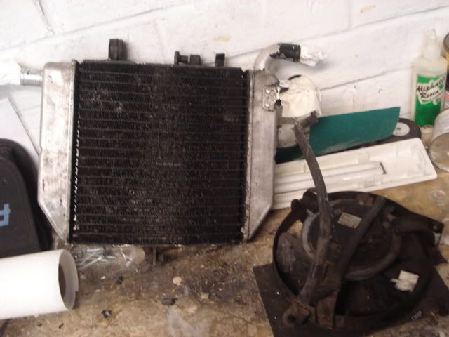

these are the rads
cant disconect the fan so have just masked the conectiong up
this one is in good nick but im gona repaint the stone guard as they have got surface rust and make it look worse than it really is
il post some more pics when they have been resprayed and have the samco's fitted and the hrc res bottle

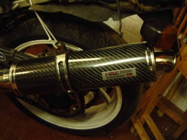

The rads are painted and I got a item i have been waiting on for a while
Yes im an imposter... but it does look very good against the carbon background and so much nice than the original scorpion badge

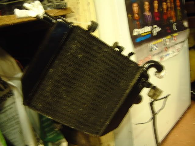

O here's a not very good pic of the lower rad drying, the upper rad looks quite good now with a fresh lick of paint
Just need to paint the stone guard, get the hrc overflow bottle and fit it all with the samco pipes and the cooling system will be sorted

nice exhaust but why the pic of harry potter on the fridge in the background of your radiator pic?!!!
