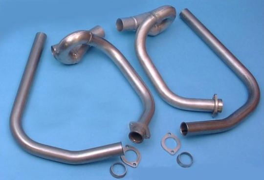

Post by Neosophist » Fri Nov 20, 2009 6:49 pm
CMSMJ1 wrote:Stubby rear manifold - NC30/35 has a little mini (heavy) stubby that then connects to the rest of the half system
Oh no it doesn't, you can fit one as their the same head pretty much (barring cams etc) but on the NC24 the rear shock is in the middle of the bike, on the NC30/35 it is moved to the left to allow the rear downpipes to join the manifold so if you fit it to an NC24 engine it doesn't fit in the NC24 frame.
The NC24 downpipes looks like so...

Post by fastdruid » Sat Nov 21, 2009 2:19 pm
Interestingly for the 750 RC24[1] at least the centre routing meant that for the race bikes they needed oval tubing for the rear cylinders, going to the single sided rear (on the RC30) gave more room meaning that they could use larger round tubing and gained 2hp.
Looking at the space available though it makes you wonder just how big the headers were!
Not quite sure with the smaller engines if it makes so much of a difference of course.
Druid
[1] After reading "Honda's V-Force" the RC24 has far more race heritage than I thought and the RC30 has far more in common with it than I thought.

Post by Neosophist » Sat Nov 21, 2009 6:42 pm
The RC24 rear headers are the ones that come down like in the picture then do a U turn yea? I havea some of those I was messing with when considering NC24 exhaust options.. :)

Post by fastdruid » Sat Nov 21, 2009 7:14 pm
Two types of RC24 headers, 86-87 and 88-89
These are the 88-89 Fj/FK ones like these
The 86-87 are quite different but I can't find a picture.
Druid

Post by Neosophist » Sat Nov 21, 2009 10:11 pm
Yeah its' the FK set I have :)
