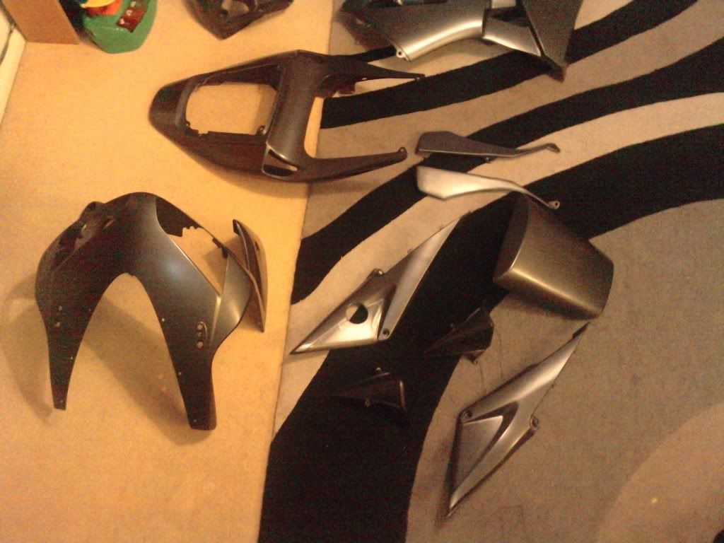

right, rather excited i have the fairings back! just painted no laquer, just waiting on brooky to send the decals in the post. i will get these fitted once more tommorrow so shes all ready for the decals. once were happy with the location of the decals back off they will go for laquer then mot time!
is not easy to see the colour finish in the pictures as its not natural light. the pictures tommorrow will look far more impressive.
steel grey is the colour,
