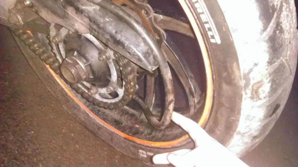

Did you not secure the brake line either?

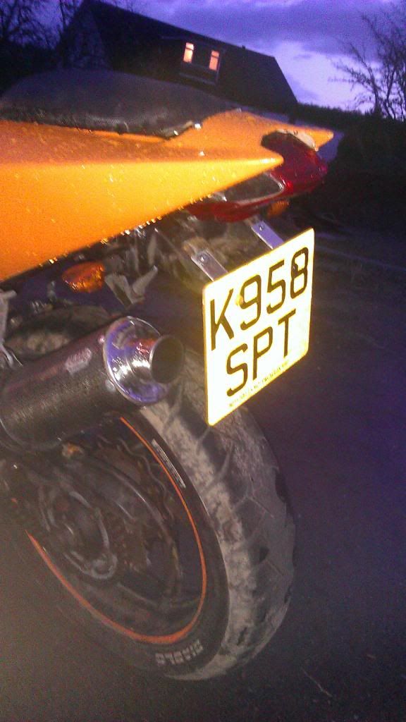

Number plate not vertical? What's that all about?

Re: 2nd MOT fail, but shorter list.
I think it means vertical as in left to right plane, rather than front to back? The after market seat unit/subframe's on the piss, isn't it?mo haggs wrote:maybe the tester forgot the bike was on the side stand?????ibby4585 wrote:
No well. because of the shitty k-con undertray, the plate holder is quite horizontal, so the plate looks flat. i made a bracket to fix that, as you can see in the picture. the second thing about the brake hose being insecure, well it is secure, it just has some excess going around the chainguard to the caliper, i could probably fix that by pushing it through towards the other end. and Neo, yes i just turned the screw down without doing proper measurements, i will google how to properly adjust the headlight aim and do it that way, also il ask the MOT guy to see if he can adjust it there if its off. The suzuka fairing also has that spacer, so thats not an issue, i think ive just done the aim wrong.
I think he's right about the hose. There's enough spare there that it could probably flop off of the chainguard and get caught in the wheel, disc or sprocket if it really wanted to. Are the clips still present for it assuming that's the stock chainguard? The chainguard looks to be bolted at the rear, I presume the front if bolted on too, in which case why is it deemed insecure? Is it split, or did you fix it after the test?
There should be a wire guide for the brake hose that is bolted to the rear chain adjuster pinch bolt...that would sort the issue.
