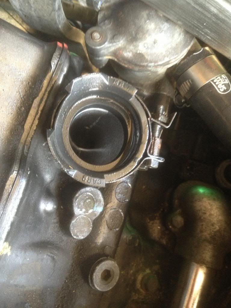

So I took everything off and replaced the offended carbs clamps with some NC30 ones and tightened it all up, making sure I had the carbs seated properly.
Still an air leak.
When I first started the bike up I noticed it seemed to have a slight pop out the exhaust while on the choke, like there was a slight misfire. Plus it needs a little throttle every time I start it to make it catch. Has full choke on when cold too, but not when warm.
Anyway when I took the carbs off I noticed a small amount of petrol sitting in the rim of each carb rubber. The bike hadn't been turned off long though.

I'm sure the carbs are seated properly, I've inspected each one with a torch. They pop into the rubbers nicely and I can see no way that they aren't in. But maybe I need a more experienced eye to take a look.....
