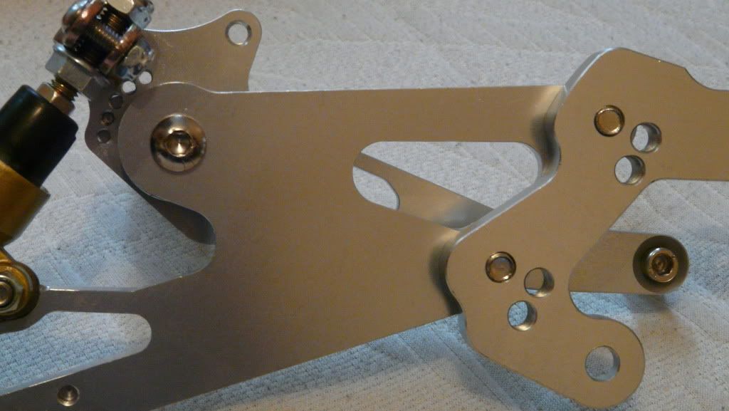

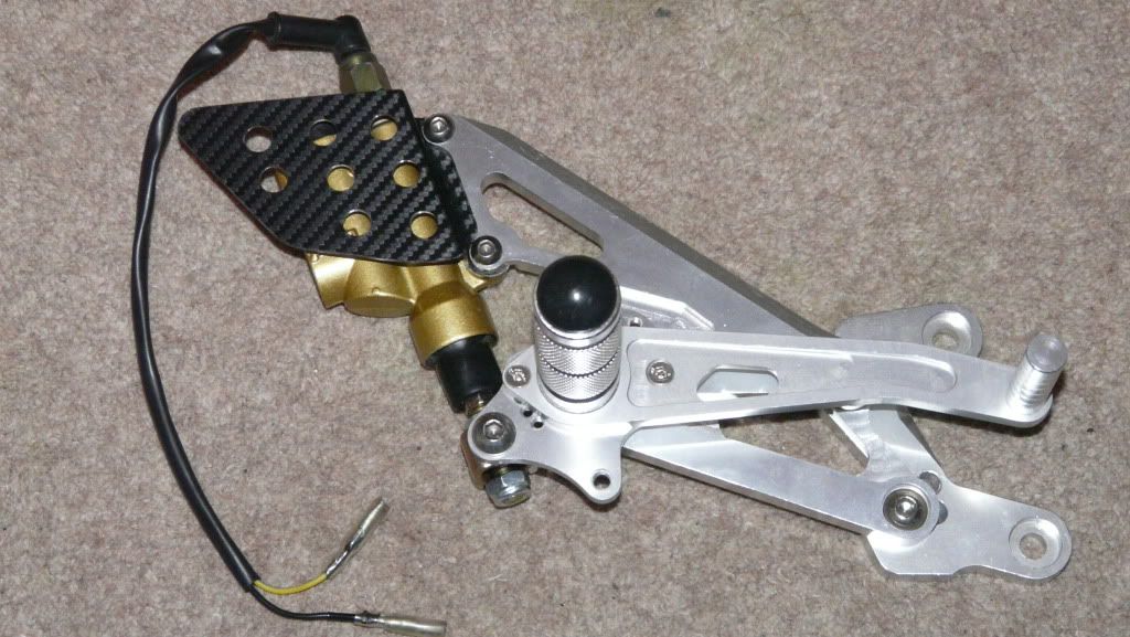

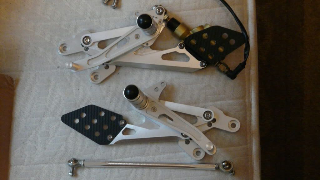

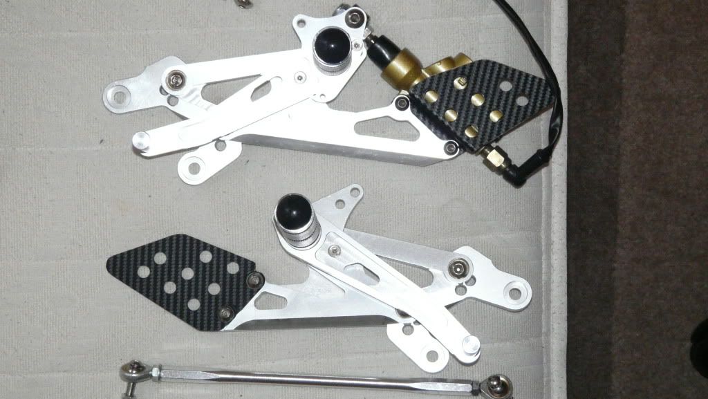

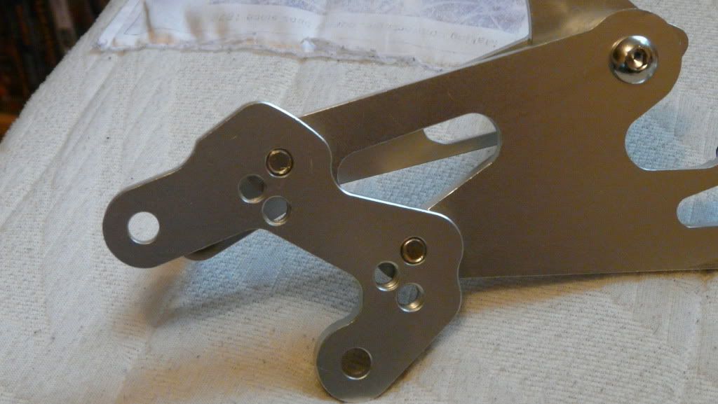

Okay my rear sets have arrived, and first impression of them is, pretty good.. they look strong and sturdy. not sure how the master cylinder is gonna cope, but we shall see. here are some pictures.
as you can see the carbon plates are not real carbon. its a thin piece of metal with carbon wrap on it. there are adjustable brackets and levers so its pretty nice.
i will test them out soon and will post up the results.

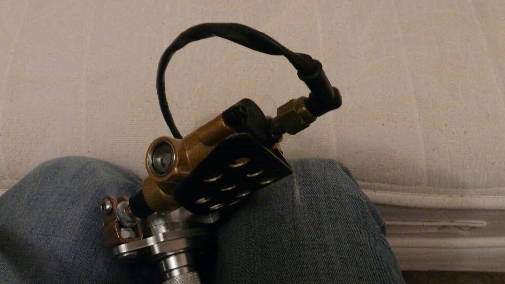

oh and i was wonderng... anyone know how i would connect the master cylinder to the brake line? i cant seem to get my head round it.. it a lot more different than the stock master cylinder. the cable on top is the brake switch it has two wires coming out.
- Deviant400
- Posts: 769
- Location: Trowbridge
Re: [ REVIEW ] After Market Rear Sets.
that bolt with the wires comming out is a banjo bolt pressure switch, so you connect the wires to where your back brake plugs in , the pressure of your foot forcing the fluid thru the switch activates your brake light, undo that bolt place on a copper washer then the brake line then another copper washer tighten up bleed brake , job done

oh okay.. so whats that glass window area? is this a reservoir cylinder combo?
Yup gonna be a fucker to bleed and maintain that, thank god its only a rear brake system and not the front.xivlia wrote:oh okay.. so whats that glass window area? is this a reservoir cylinder combo?
