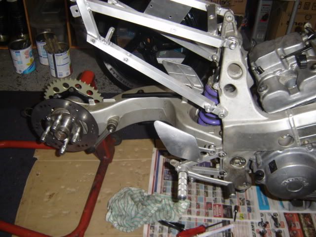

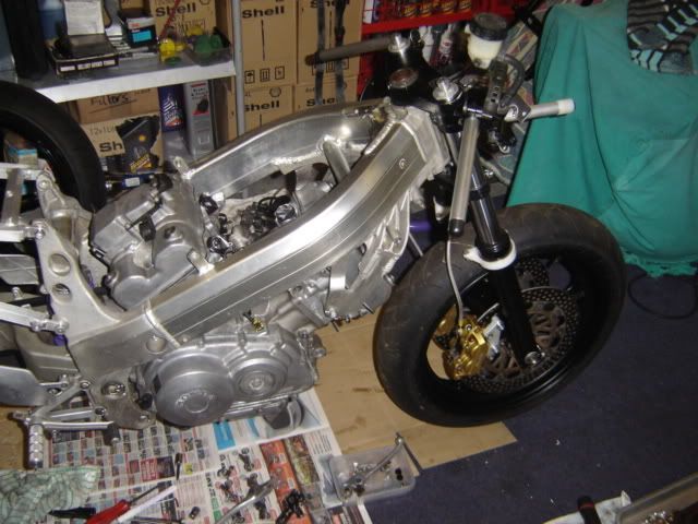

Couple of pictures below of a race NC30 currently in build - due out very soon.
