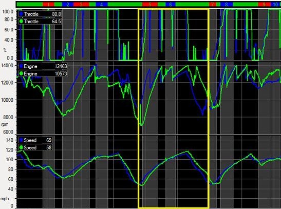

I'll go over the data from the Barber Motorsports round from a couple weeks ago and try to pull some concrete evidence for you. My motor is definitley snappier but we tossed out all the quitening gearsat the same time.

Look in the area outlined in yellow. It's a good example of how well the motor spins up now. Even after carrying a full gear higher into the corner, getting back on the gas a little late by the time I enter turn six I am already carrying more speed that the previous event. Total lap time for the 2 laps was only tenth of a second apart but the bike pulls better right off the corner. Gearing was the same during both laps.

Thank you so much for that Data Acquisition clip. That was more telling than I could have done with the dyno.
