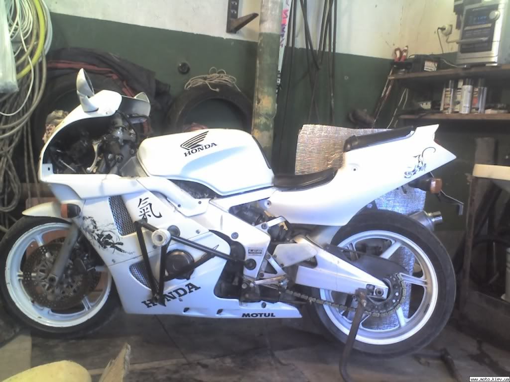

PARUS
Posts: 1160
Location: Seattle, USA
Re: NC23 Crash Protection
Post by PARUS » Tue Oct 27, 2009 11:09 pm
We have made following. This is not for NC23, but I think easy can be done same for NC23
As for the swingarm and forks bobbins I would say it is useless, because generally three point damage - mirror/lights, tail unit and left\right engine casing.
