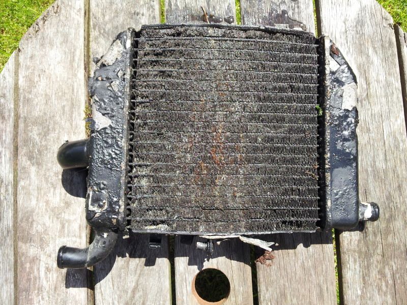

OK, wrong again! It wasn't easy to tell what mine was originally made from when it came off...
For some reason the coolant temp rose quickly when stuck in traffic.... :whistle:

Post by hunter » Mon Feb 18, 2013 10:52 pm
A lick of paint it will be as good as new. :smile:

Post by speedy231278 » Tue Feb 19, 2013 10:21 am
Be VERY careful if you try to take the fan off. When the rad looks like that, you often find the brackets are returning to nature and are corroded and splitting. The fan shroud retaining bolts often get corroded into the brackets, and the just rip off. Been there, done that, even holding the bracket to try and minimise the load on it. Bottom rads seem to be fairly common on eBay, you might find a healthier one. I got a belter just over a year ago for not very much, and it was near mint.
