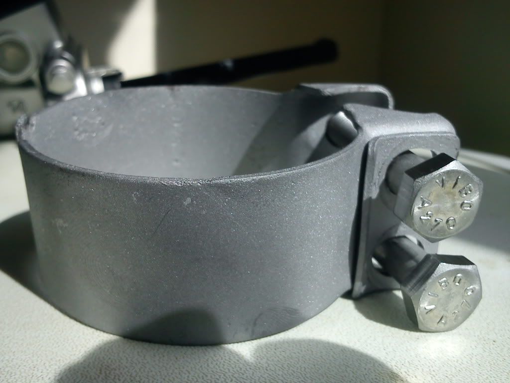

Silencer clamp sand blasted ready for paint.

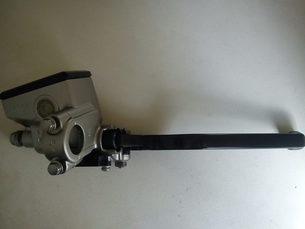

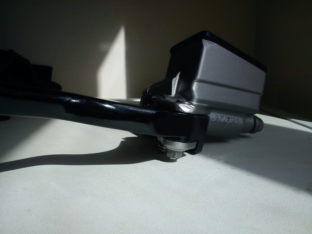

And front master repainted and re sealed.
