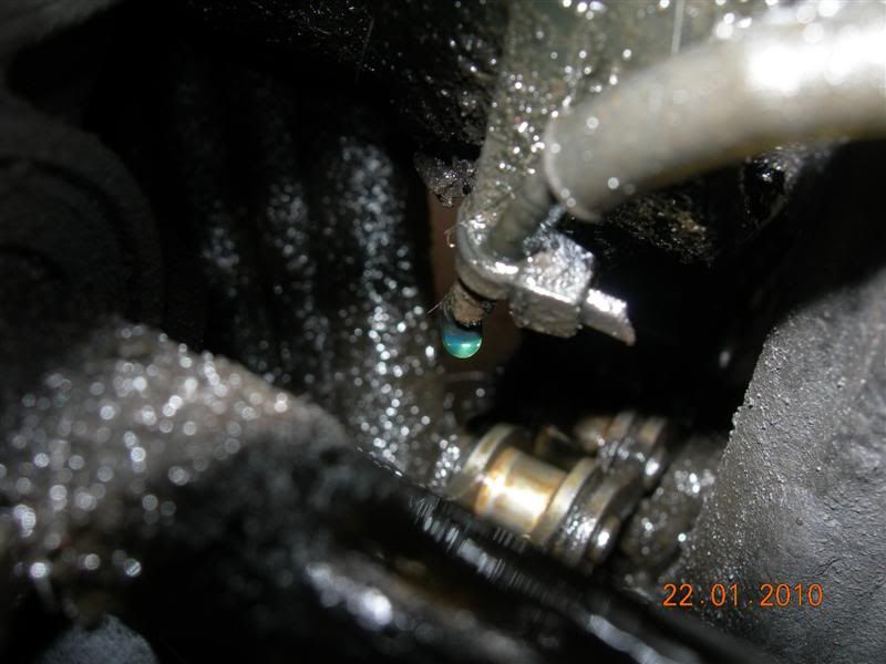

I stopped fitting the feed pipe to the rear sprocket, it blocks easily, only lubes 1 side of the chain, needs pipe/tiewraps along the swingarm & snaggs when refitting the rear wheel (not a prob on the '30/5). Much better to fit the outlet behind the front sprocket.

thats a really good idea that phil. you got any pics of yours and where its exiting ?

CRM wrote:thats a really good idea that phil. you got any pics of yours and where its exiting ?
I have a pic somewhere, I'll try & dig it out ;-)
Not on an NC30 but I'm sure it'd fit somehow just make sure that there is no less than 5mm or so sticking down otherwise the oil doesn't drip, it just runs along the chain slider.
BTW, don't laugh at my anti-corrosion policy :P
