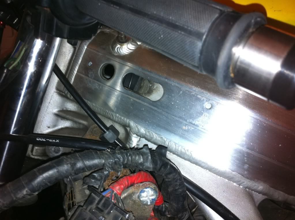

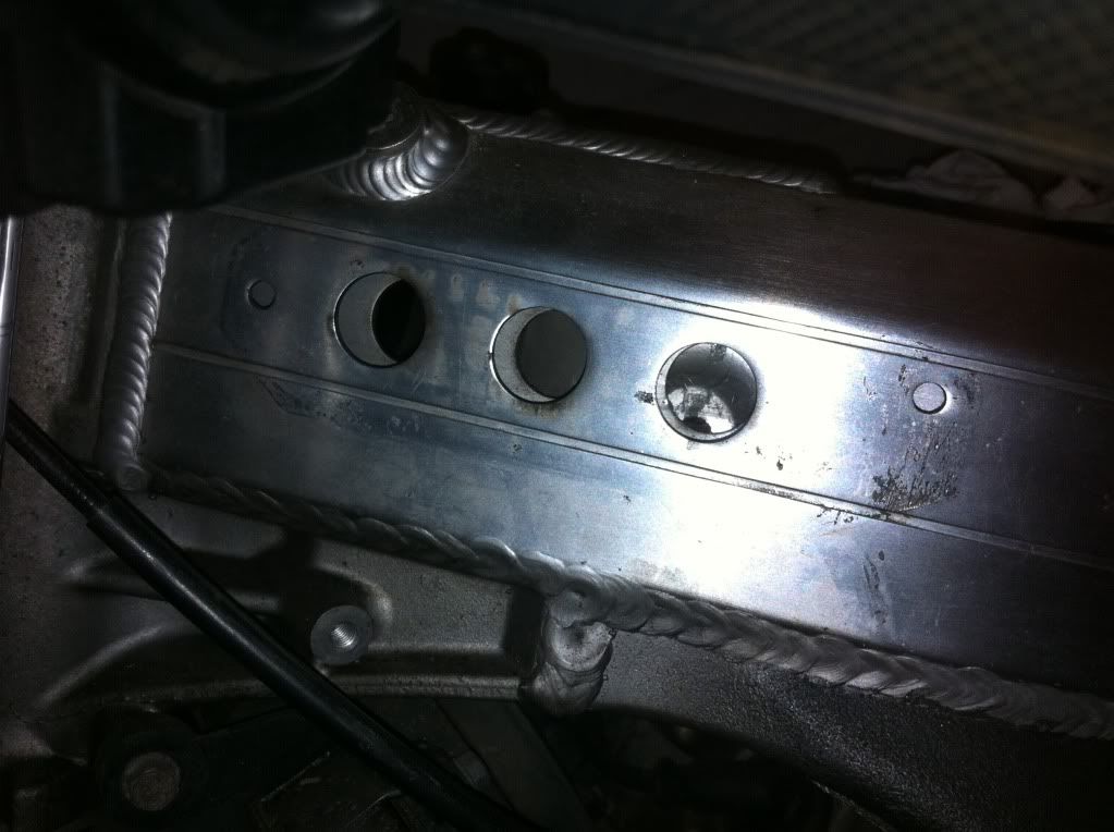

The rrk Does have holes in the frame. But the joint blanks them off.
http://i304.photobucket.com/albums/nn18 ... 2DB863.jpg - RRJ
http://i304.photobucket.com/albums/nn18 ... DD5297.jpg - RRK
Just seems like the capability is there for the directed air but for some reason they choose to blank it off and down jet the carbs for '89. Does anyone know anything about this ?
