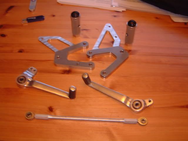

HRC rearsets arrived and now iv just got to work out how the hell I put them together. :) anyone got a exploded diagram or something that could guide me?

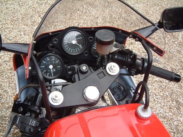

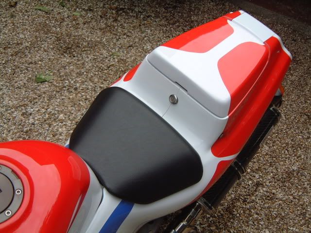

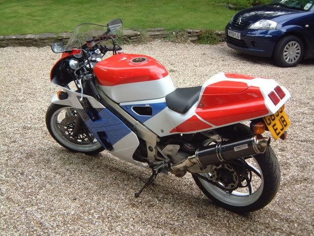

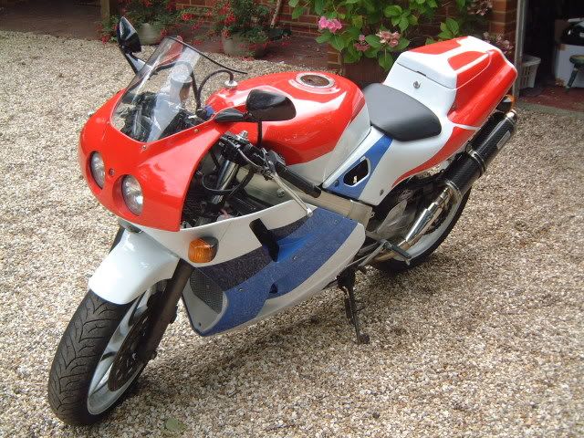

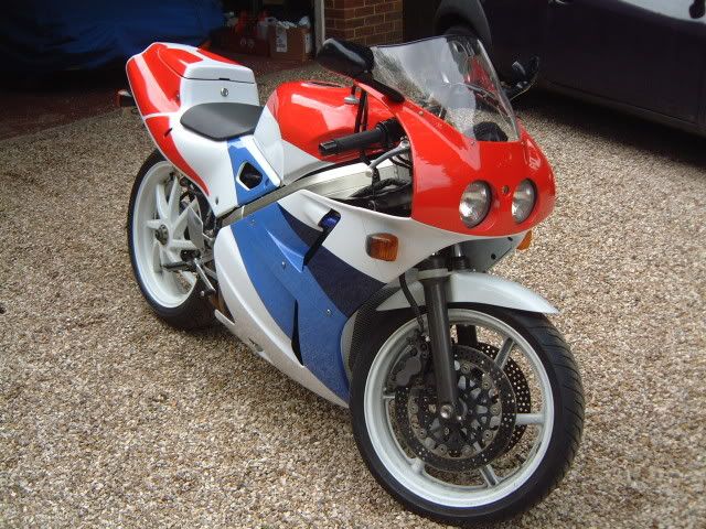

stop press!!!! Iv finally got some piccies worth showing!!!
still awaiting graphics and am not sure whether to go for the hislop rep ones (without the front number board for now) but her she is
yes im aware the single seat cover dosent match fully and that will all be sorted soon free of charge by the painter (he couldnt put the seat unit together as I had all the bits so he had to guesstimate and i think he did quite well, (and all for £250)
o and the HRC rearsets arrived, thay also came with a load of nuts and bolts but i cat work out how to put them together, any help would be appreciated
in fitting the fairings I had to relocate the HRC resevior as it wouldnt fit on the right hand side fot he top rad so its now on the left, means i can check level and top up without removing any fairing too
RVFHooligan
Posts: 344
Location: Tampa, FL, USA
Re: My NC30 Project!!!!
Post by RVFHooligan » Thu Aug 21, 2008 2:05 am
Very nice Spike! Looks like the painter did a great job. That's about what I paid to get my plastics painted, $500 USD. It looks good the way it is, even without the graphics. Now get out and ride the wheels off it. Cheers.
Post by Drunkn Munky » Fri Aug 22, 2008 12:56 pm
£250 for that paintjob!! I think thats a bargin mate, looks really nice. Wheres he based?
