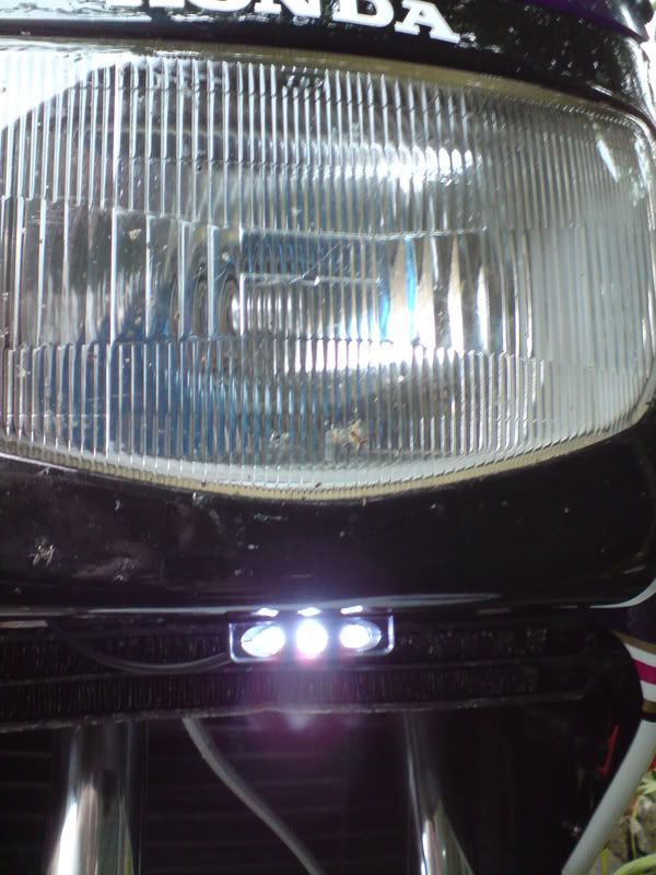

A little thinking came up with this:
http://i109.photobucket.com/albums/n61/ ... C02020.jpg" onclick="window.open(this.href);return false;
Is an LED numberplate light for bikes soldered into the sidelight live feed and earth off the indicator?? Low draw rate plus the two side bulbs are angled at 45 deg. so it can be seen from the side as well?? Weatherproof & quite bright, def gets you seen.... :D
